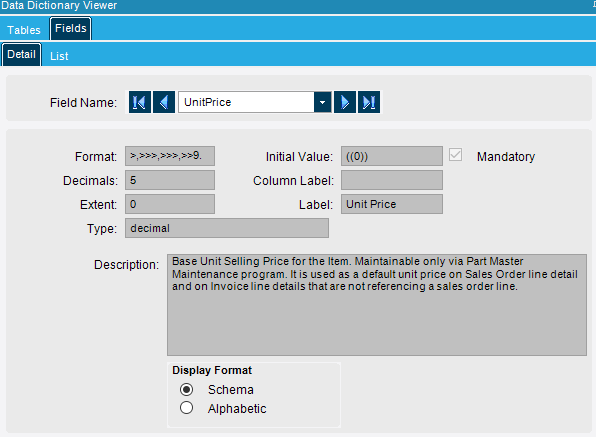

Does Epicor reduce the default SQL precision and scale to what’s shown in Data Dictionary Viewer (and Extended Properties Maint)?
E.g. 5, for Part.UnitPrice

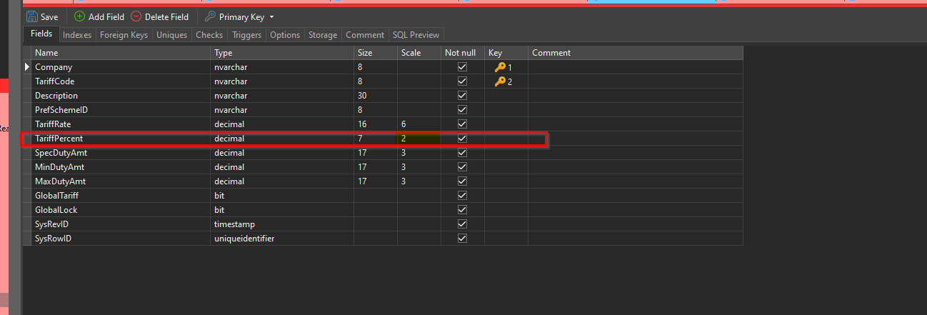

It’s set in the DB for scale of 2. So in this case Ext Props can’t save us it’s not a format in this case.
Nice find.

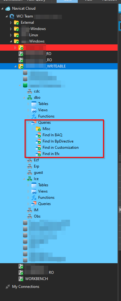

Navicat FTW
This guy knows what’s up!! Saved team cloud queries and saved connections FTW!
