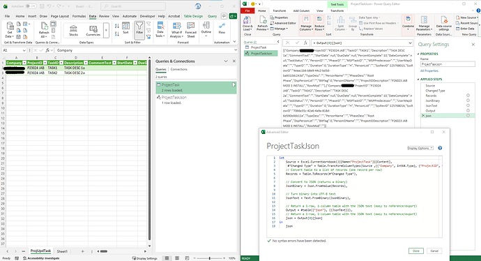

let
    Source = Excel.CurrentWorkbook(){[Name="ProjectTask"]}[Content],
     #"Changed Type" = Table.TransformColumnTypes(Source ,{{"Company", Int64.Type}, {"ProjectID", type text}, {"TaskID", type text}, {"Description", type text}, {"CommentText", type any}, {"StartDate", type any}, {"DueDate", type any}, {"PercentComplete", Int64.Type}, {"DateComplete", type any}, {"TaskStatus", type text}, {"PersonID", type any}, {"PhaseID", type any}, {"MSPTaskID", type any}, {"MSPPredecessor", type any}, {"UserMapData", type any}, {"TypeID", type any}, {"Duration", Int64.Type}, {"DurationType", type text}, {"PersonList", type any}, {"SysRevID", Int64.Type}, {"SysRowID", type text}, {"TypeDesc", type any}, {"PersonName", type any}, {"PhaseDesc", type text}, {"DspPersonLst", type any}, {"BitFlag", Int64.Type}, {"PersonIDName", type any}, {"ProjectIDDescription", type text}, {"RowMod", type any}}),
    // Convert table to a list of records (one record per row)
    Records = Table.ToRecords(#"Changed Type"),
    // Convert to JSON (returns a binary)
    JsonBinary = Json.FromValue(Records),
    // Turn binary into UTF-8 text
    JsonText = Text.FromBinary(JsonBinary),
    // Return a 1-row, 1-column table with the JSON text (easy to reference/export)
    Output = #table({"json"}, {{JsonText}}),
    json = Output{0}[json]
in
    json
