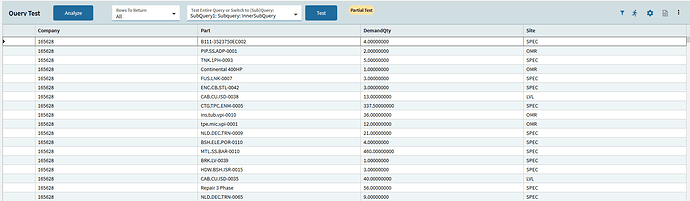

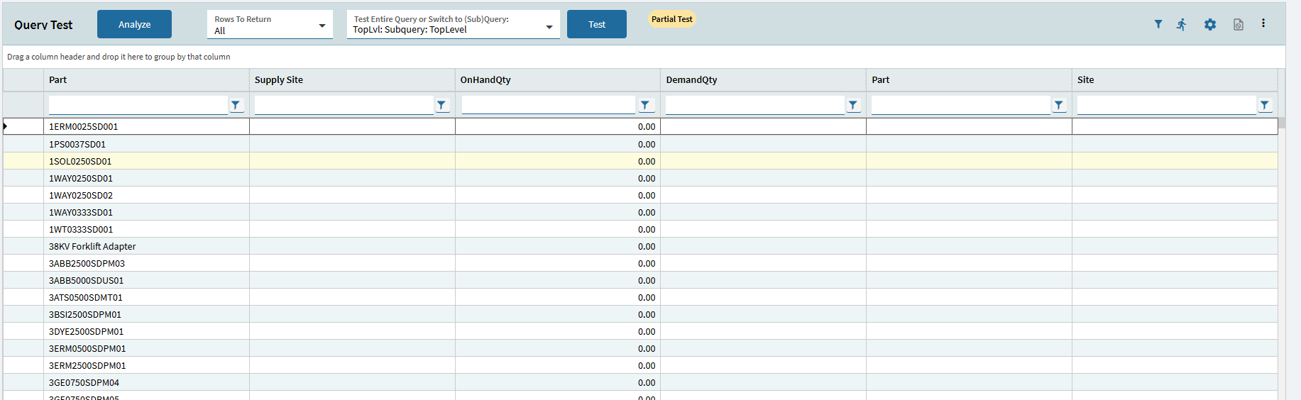

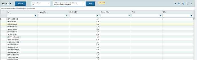

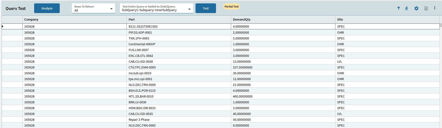

So far I am having troubles getting the results from my subquery to populate. PartDtl being the subquery and PartWhse being the top level.
PartWhse.Company = PartDtl.Company
PartWhse.PartNum = PartDtl.PartNum
PartWhse.KBPlant = PartDtl.Plant

That join on PartWhse.KBPlant = PartDtl.Plant is likely your issue. You need to pull in Plant from the Warehse table. You can do this either by making an inner sub query with Partwhse joined to Warehse and then make sure you have Warehse.Plant selected in your fields, and then you can easily join that inner subquery to your other subquery. Another option is to just add Warehse to your top level, join on partwhse (company/warehousecode) and then in your join for partwhse to subquery1, on the left type in Warehse.Plant (or if you’ve already used Warehse elsewhere, the Warehse table you added will have an alias, e.g Warehse1, use that, and I believe the BAQ editor is case sensitive) where KBplant currently exists so you have Warehse.Plant = Partdtl.Plant.
