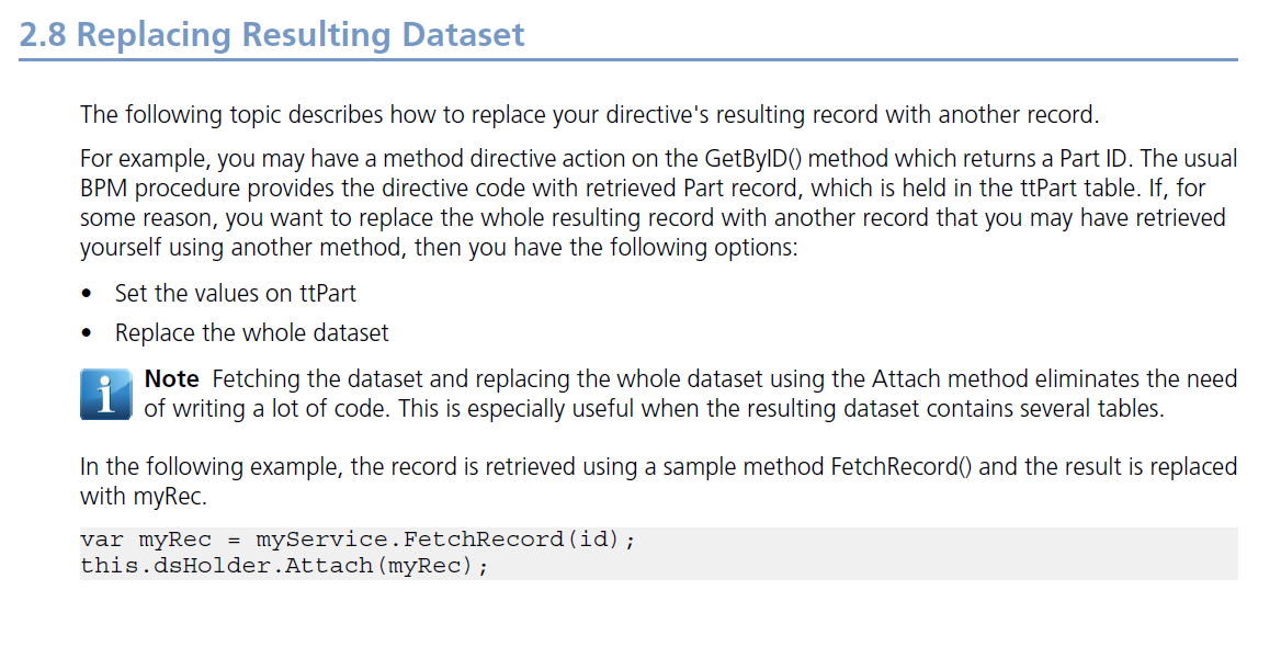

Also @josecgomez , I have one last question: I found a section in the programmer’s guide that seems relevant:
So I created a Condition box that checks if a non-engineering user is triggering PArt.GetList, then runs this custom code:
var releasedOnly = from a in Db.Part
where a.Released_c == true
select a;
this.dsHolder.Attach(releasedOnly);
This causes an error stating that the script does not contain a definition for dsHolder. I also tried replacing dsHolder with ttPartList, but then it told me ttPartList does not have a definition for Attach(). Do you know what I need to declare, and how to declare it?
