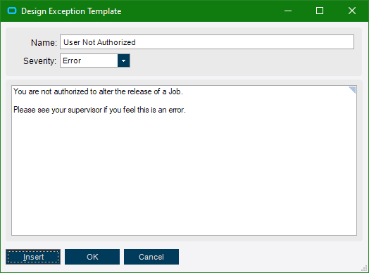

@Nathan - Any tidbits to share regarding Field Security vs restricting it via an In-Trans Data Directive (with bonus pop-up box on why that specific end user can’t change it!)?
@askulte Something like this?
Trying to release Job?:
Authorized to Release Job?:
UnAuthorized:
User Not Authorized:
