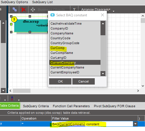

Can someone explain to me the difference between CurComp and CurrentCompany in BAQ Criteria filter value.

My understanding is that there is no difference, except that CUrComp is just for E9 compatibility and CurrentCompany is the preferred way. So I think the later is the best choice for long term use.
