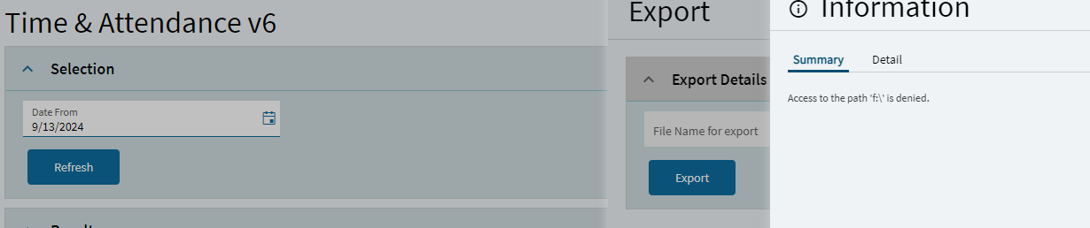

We are in the Gov Cloud currently just upgraded. However when trying to export for example Time and Attendance dashboard I get "Access to the path F:\ is denied… They set us up with Azure File Share and I’m super confused on whats going on here. Has anyone here come across this before?
Can you tell us how you are trying to export, I’m not familiar with it.
Might be something you can configure.
Run it from the Epicor menu, not from a shortcut on the main Epicor screen.
We had an issue with the shortcuts being messed up during an upgrade and we had to redo them again.
