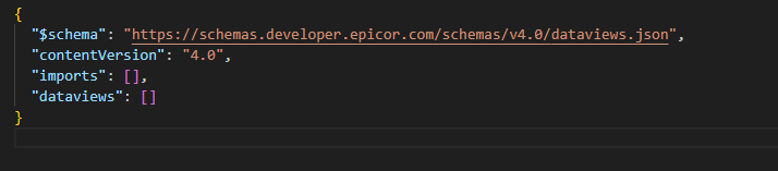

I exported dashboard from app studio and imported it to Live environment, all good but it is imported but all actions, views and etc. were gone. Am i done something wrong? How you guys migrate custom dashboard from test to live?
This is how exported file like dataview.jsonc looks like inside :confused:

Was the dashboard published in your test environment? We use the export/import all the time with no issues.
:poop: it was published. But not published again after adding views and etc
