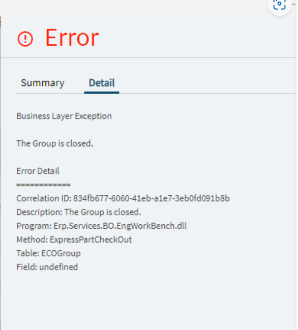

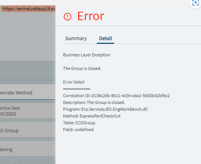

A particular user getting an error while using express part checkout. I have checked the group, and group is open and I can be able to access and entered same part in Express part checkout.
Any thoughts.

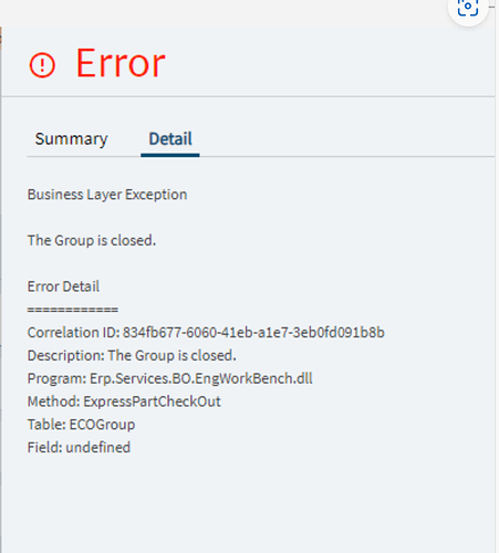

I can be able to do the Express Part check out whereas a particular user is trying to do with the same part he is getting a below error.
