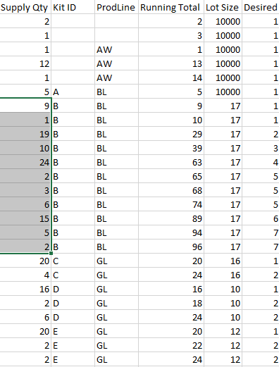

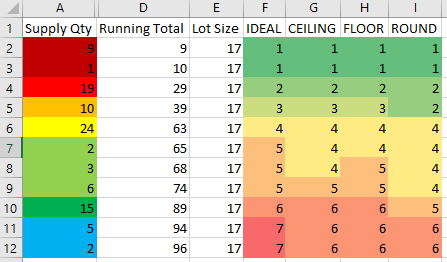

I have a need to group records in a BAQ where the sum of a number of rows will not exceed a certain value (in this case 17, but each upper group has it’s own Lot Size) unless the record itself is greater than the value. The below image is already filtered down to one group level for simplification. I need the Supply Qty to be summed and grouped. I already have a Running Total (partition by…) working, but as you can see I cant get the IDEAL value. I have included my previous attempts with ceiling, floor, and round, but I don’t think this is the correct approach.

Short version is I want to group by ProdLine, Kit, and Lot ID (which is an incremented value based off of a sum that must reset before the lot size is exceed.

Here is a fuller set of data. It is grouped by the Kit ID and The Prod Line. These define the Lot Size (simply the max size of the intended job). They are previously sorted by a date value (not shown) for each group. I want to provide a Lot ID that matches the “Desired” column. My first attempt was to get the running total for each group and divide that by the Lot Size to get a number that could be my Lot ID (using CEILING). However, it would often not create enough Lot IDs because a single Supply Qty could be more than the Lot Size (should be it’s own lot), but because the previous lots were small, it would not create a new subsequent lot.
