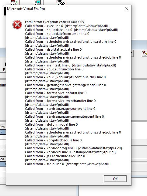

Fatal error: exception code=c0000005 (VFP6R.DLL)
Epicor vista 4.4
whether I’m trying to find a previous job or adding a part numbers or any task I have to do: it’ll give me this error code (C0000005) and then asks me to restart the program, after restarting it lets me continue for a bit until I have to create a new job and then crashes again. [vista error 1-12-2026]

Does this happen at every work-station? or just yours. Check on a different machine, if it doesn’t happen there… Visual Fox Pro used to be a … real pain when your user resource file got corrupted. Since it doesn’t appear to be related to specific data it may be that you need to clean up your FOXUSER.FPT / FOXUSER.DBF files (rename them)
(I googled this I don’t actually know much about Fox Pro) but it might be a hail mary

I did a search, and it seems that this is more of a “memory” error and could be one of many causes… when I did a google of Fox Pro and C0000005, I got multiple possible things. Here is one thread I found: C0000005 error and troubleshoot - Visual FoxPro | Microsoft Learn

What operating system is it running on? If it’s Windows 10 or later, you may have to turn off Memory Integrity in the Core Isolation settings.
