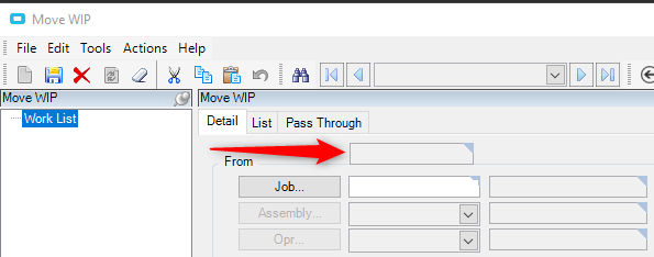

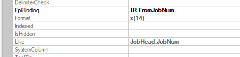

I’ve added a Textbox in the Move Wip Form, binded it to IR.FromJobNum same as the one besides the Job Button. But, when I reopen the customization, my textbox is in ReadOnly mode.
The only difference is the EpiKeyField property. It is set to false. When I change it to True, the TextBox is no longer ReadOnly. It is available.

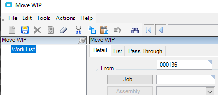

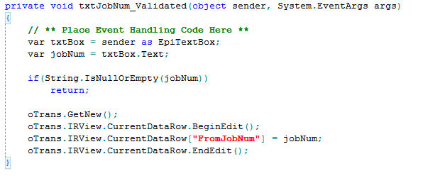

When I type a Job Number, it does nothing (no search). Do you have any clue?
Okay, Got it.
