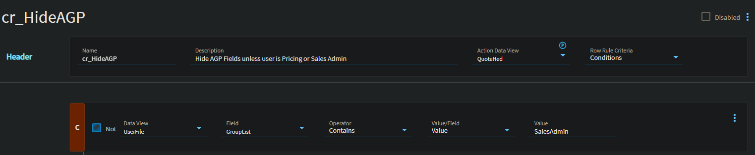

I tried using a method directive with when value changes, this works, but only when the user changes the value. I like the field security as it stops them from making the change to begin with. I wonder if I could use a customization to hide the field(s) depending on the security group and to show a separate field/label showing the message?

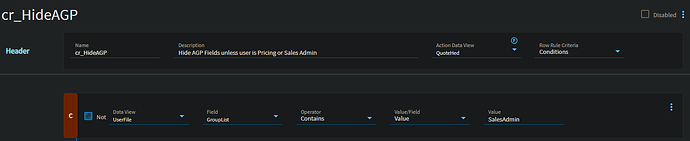

This you can definitely do. The UserFile data view has a GroupList field which is a ~ delimited list of all the groups the current user is in. I’ve used this to hide fields and only show them to certain groups with a rule like this. For the actions, I used SettingStyle.Invisible for the fields I wanted to hide.
