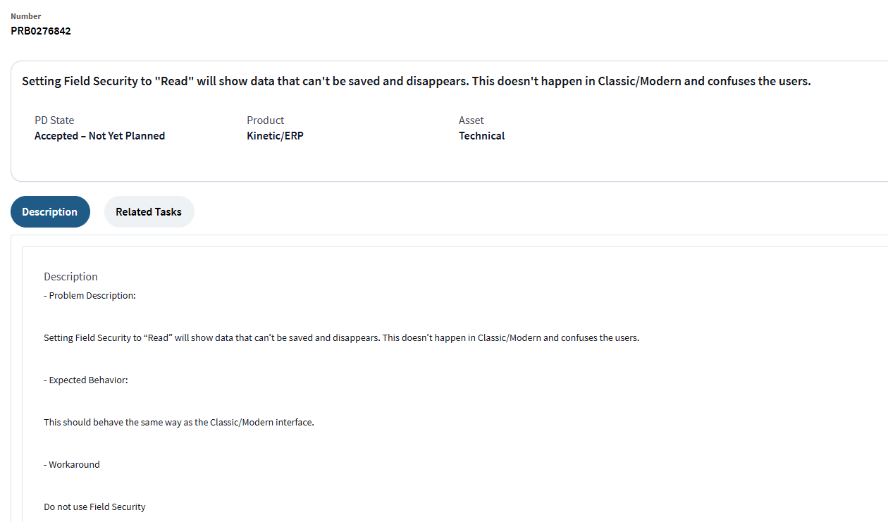

Has anybody developed a workaround for this? I asked support for a status on this issue and they actually gave me a different problem number, but looks like the exact same problem (PRB0276842).

Problem has not been touched.
