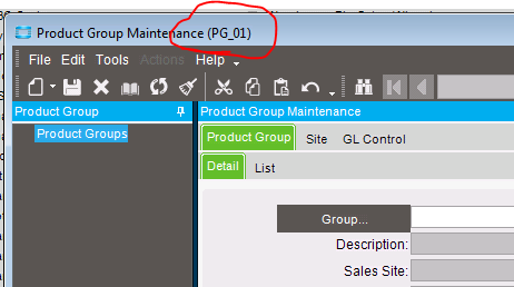

When when customize a screen (form, window, whatever you call it), we:
  1. Name the customization like PG_01 (for the first customization to the Product Group screen).
  2. Add the customization name to the window’s title
  3. Rename the Menu to display the customization used
Note that this menu shows both the base “Part”, and customized “Part (PE_02)”. Menu security is used to determine which is shown. Only Security Managers can see “Part”. Everyone else only sees “Part (PE_02)”.
