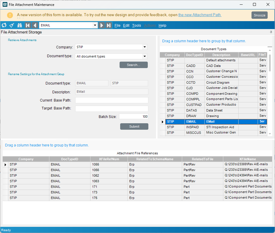

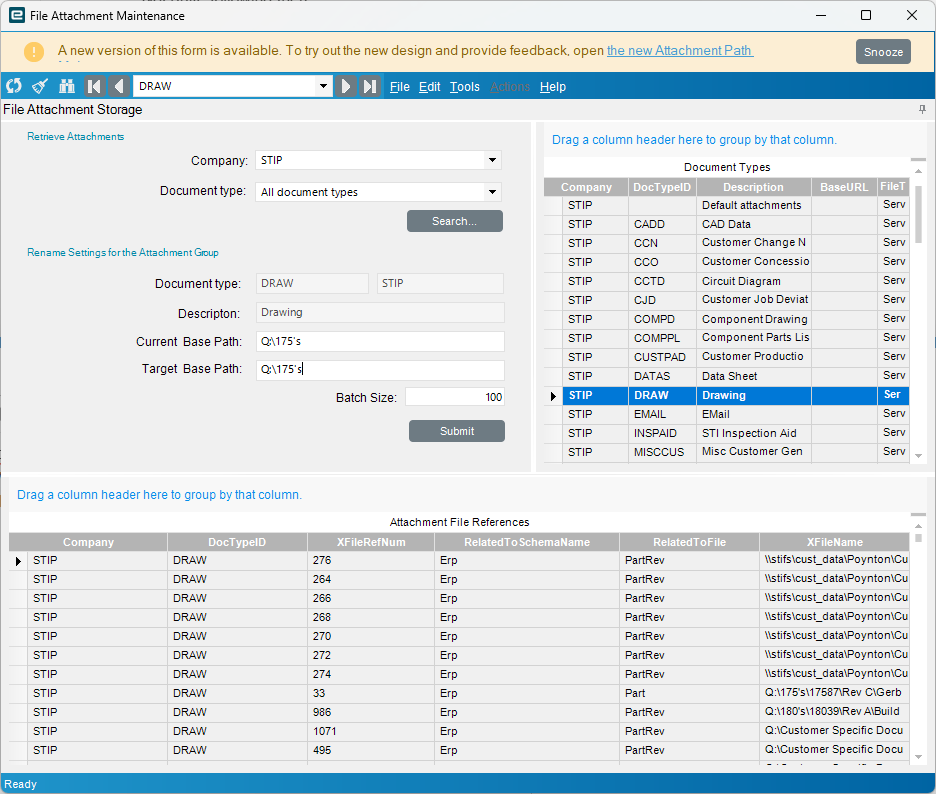

Unfortunately in days gone by someone thought it would be great to put apostrophes in the file system naming which of cause the DMT process does not like so i am have to change those apostrophes with something else and then change the path to the correct path in File Attachment Path maintenance. I just seems labourious that you have to do it for every file type when ultimately it is only 10 to 20 paths that need to be amended in total.

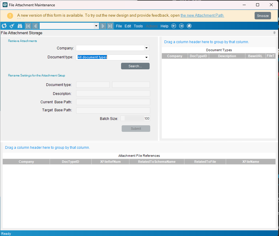

The File attachment maintenance in kinetic allows you to select the option for all document types In classic, but it appears not in the kinetic UI by the looks.
Looks like another oversight for Classic compatibility issue, or perhaps usability. There was an idea for this, but it is expired Log In - Epicor Identity

It allows you to select all the Document Types, however you can only amend the file path for one document type at a time.
When you click on the next file type you lose the Current and Targe Path Details
