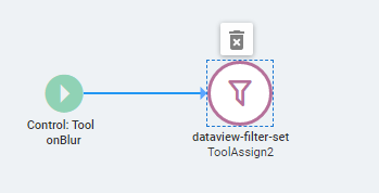

Since these questions remain open, I figured I’d add to this. I am trying to filter a selection-list as the user types in a textbox. I created a Control-OnBlur event for the textbox.
There I added the dataview-filter-set for the dataview my selection-list is bound to and filtered it:
Calculated_EquipIDWithDescription LIKE ‘%{CallContextBpmData.Character01}%’
No errors, but nothing happens when I type in the txtbx or tab out of it… Maybe my filter is setup wrong? Do I have to refresh the dataview after it’s filtered?

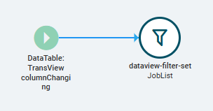

Only 2 years late. It’s cool. :sunglasses:

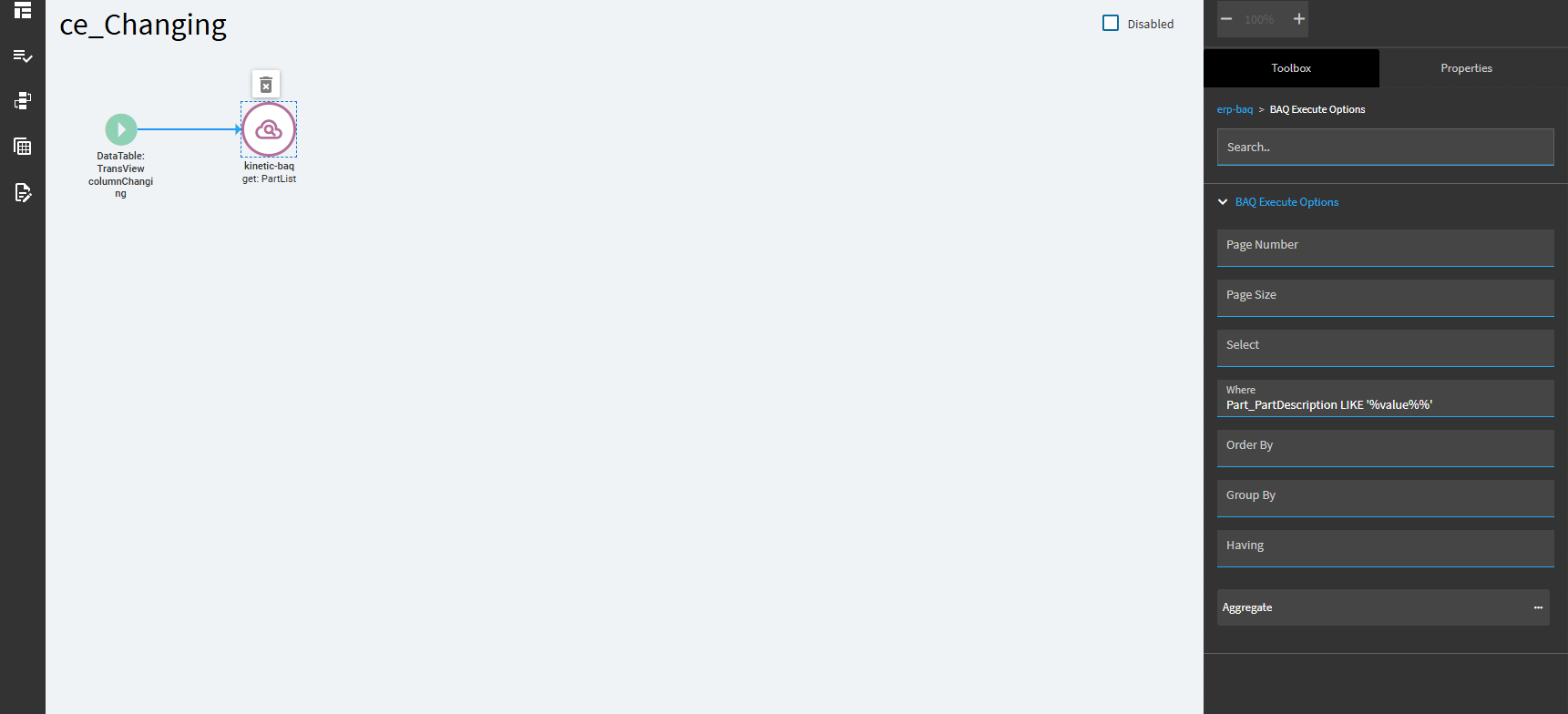

JobHead_PartNum LIKE '%value%%' OR JobHead_JobNum  LIKE '%value%%'
%value% holds the “Changing” value.
Adding a second % makes it akin to a starts with. Use %%value%% for a contains.
DataTable.ColumnChanging used to do this, but it does not seem to anymore. I’ll have to play around.

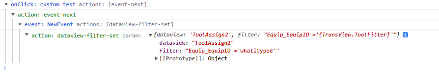

Lots of weirdness in version 11.2.400.9. I setup my dataview-filter-set param and filter it accordingly using TransView.ToolFilter. I event made the event just a button click. Trace shows the event is doing what it is supposed to do:

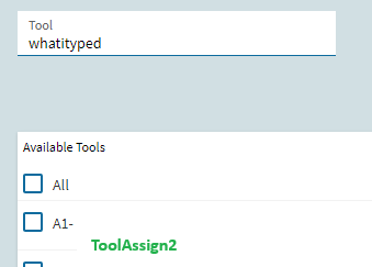

Available selection list remains unchanged:
My available tools should be blank.
I know the widget is supposed to filter the dataview, but should I run the BAQ that populates it again?

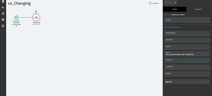

Selection list works differently. Instead of the dataview-filter-set, you just call the BAQ that populates the source again, but include your filter in the execute options.

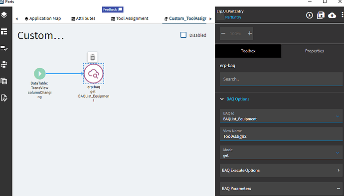

Sorry for taking forever in responding here. Must be my version (11.2.400.9); selection list refuses to cooperate. When I change the value, I can see it’s running the BAQ with my filter, but it’s not updating the dataview bound to the selection list control. The same dataset that it gets when the screen loads continues to display.
Let me see the properties for your list.
Sorry again for latency :slight_smile:

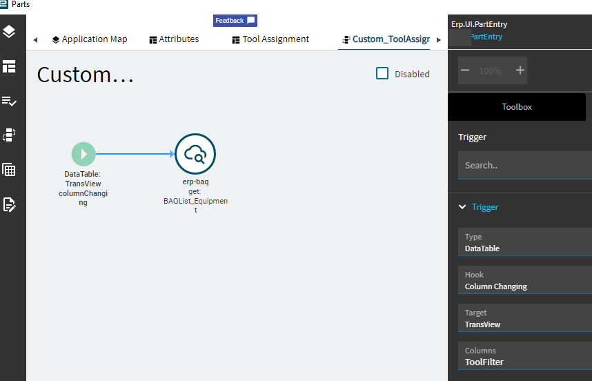

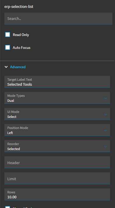

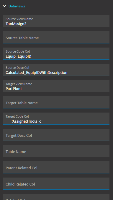

List Props:

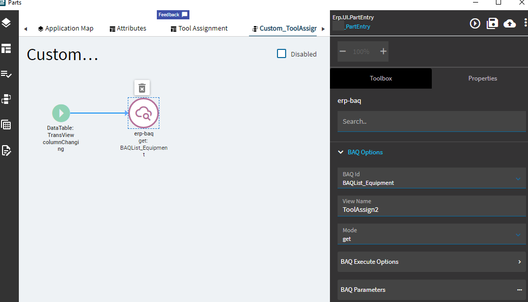

Event and BAQ:
BAQ Options:

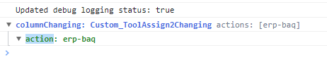

Perhaps the columnchanging event is broken? It doesn’t process as I type, but only when I tab out. BAQ doesn’t seem to do anything either:
