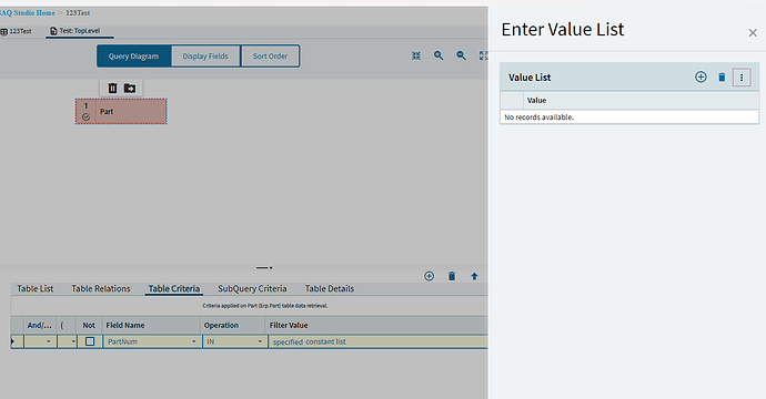

I have a large list of parts in an excel column that I want to set as the criteria for the Part Table in a BAQ.
Rather than entering these one at a time which is how the in “specified constant list” works, is there an efficient way to get the whole list from a prompt similar to sql in (‘xxxx1’, ’ xxxx2’, ‘xxxx3’, etc.)?

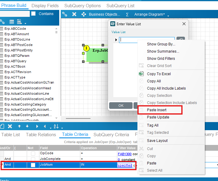

For now you will need to use the baq designer in classic mode to paste insert your values.
Simpleton here is missing it … What’s the correct syntax or WHERE do you paste insert?

Thank you Jeff!
learned something New! Thanks!
