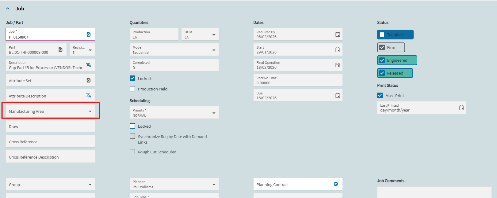

Hi David, i want to do it in Job Entry when we create the job
Well, as soon as you create a new job, the JobHead dataview should be populated. So, you could add a Filter of: ShortChar01 = '?{JobHead.Plant}'
I never know where to put the filter, trial and error.

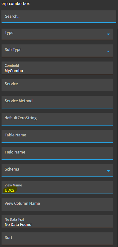

I got it to work… using Ice.BO.UD02Svc, GetRows.

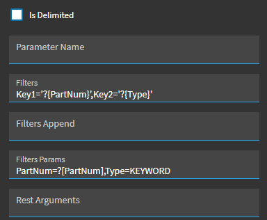

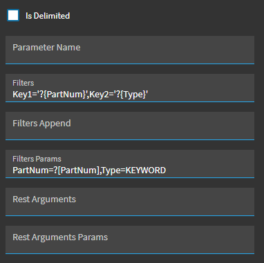

My UD02 table is used for something completely different, so you’ll have to forgive my example is not even close to what you’re doing… but…

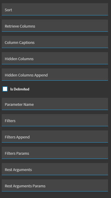

In Filters, I’m defining what my filters ARE… you can call these whatever you want.
For example, you might be able to set up a filter of ShortChar01='?{MyFilter}'
In Filter Param, I’m telling it what column to look at (IN MY Combobox’s bound dataview) to find the value.
(You can ignore the Key2 filters… I was just testing a secondary filter based on a static value… and that worked as well)
So, in my example, my combobox was bound to TransView.MyCombo
I’m telling it to filter my UD02 Key1 based on a filter I call ?{PartNum}.
In Filter Params I’m saying “PartNum” should equal ?[PartNum] value… and it looks at TransView.PartNum for this value.

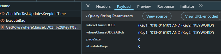

These “Filters” get added to your whereClauseUD02 (which you can see in debugger > Network > Payload on the GetRows):

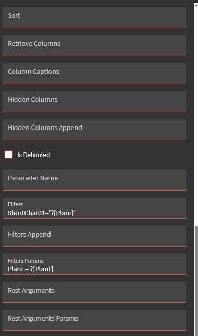

So… for your use case… I would try:
Filter: ShortChar01='?{Plant}'
(and again, I think you can call that anything.. but your Filter Param will need to match whatever you choose to use)
Filter Param: Plant = ?[Plant]
(and since your combo is bound to JobHead, it should look at JobHead.Plant for the value).
NOTE: Filter uses curly brackets… Filter Param uses Square Brackets.
Give that a try and see what happens.

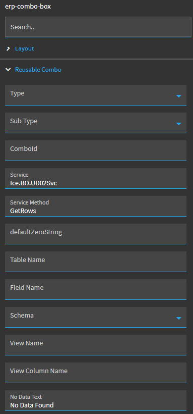

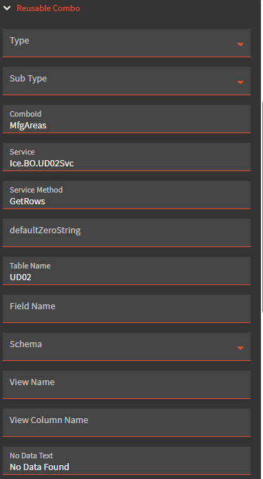

Should i be filling anything else in on the Re-Usable Combo?
I am still getting the same error

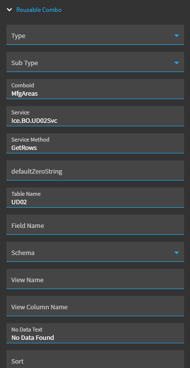

Take your Table Name out, see if that’s causing the issue.

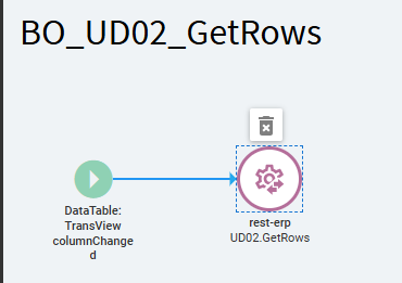

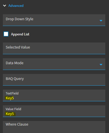

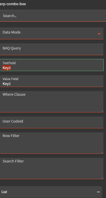

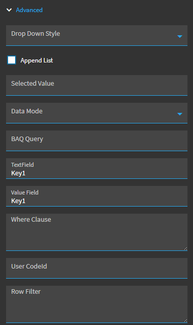

Here are my settings:
No change

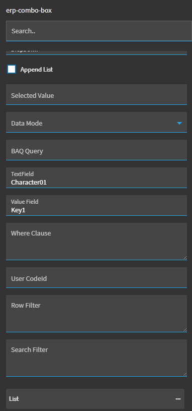

For some reason it is not filtering at all, i changed the setup so that it was using Key1 as the Plant in my UD02 table and then changed the filters in the combo box on Job to replicate what you have done and it lists all the areas in UD02 not a filtered list :thinking:
So i can filter the list with a fixed filter such as Key1='mfgsys' but it isnt filtering based on anything else.
Yeah, I was able to filter using a fixed/static value without any issue. But I had to use the Filters & Filter Params in order to use a value based on a dataview.column.
Have you tried doing a reset? I wonder if App Studio if holding on to some setting in the background which you’ve changed. Save, exit app studio… come back in, check your settings to see if they’re what they should be.
I’m sorry I don’t have a better solution.

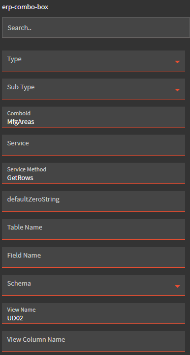

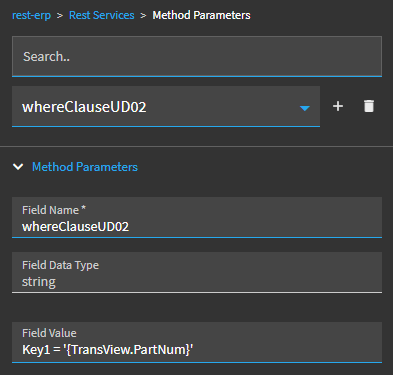

Alternative Route:
Since this approach isn’t working, you may try using a dataview to populate the combobox. You would need to create a UD02 dataview. If you use the wizard, it will create the Get event for you. You can set the BO to Ice.BO.UD02Svc and Method to GetRows.
In the event it creates you’ll have to set the Method Parameters:
Toggle through each parameter… whereClauseUD02 and whereClauseUD02Attch will be the same.
Page Size and Absolute Page can just use a value of 0 (but you have to put something in there).
Then set the trigger to whatever makes sense. After form_onload… or somewhere early so you know the dataview gets populated.
Then your combobox settings would just be (3) settings. The name of the dataview you created for UD02, and then the text and value fields under advanced:
I just tested the above and it worked for me.
Thanks for your perseverance with this David, not sure why the first method didnt work but the second seems to be working. I will do some more testing first but at first try it looks good :+1:
