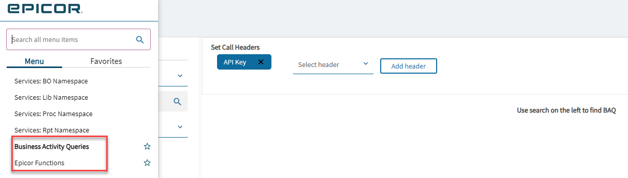

@TomAlexander would you mind posting an example of the Get and Post as you are using them, I am not familiar with this approach, thank you
In REST Help page you can browse BAQs and Functions:
