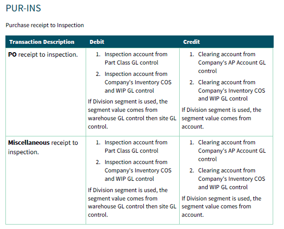

I’m trying to see (since we don’t use epicor inspections) whether we never set up the other side of those transactions. So it is crediting one side but not entering a matching debit.
Right. You know how to use the hierarchy guide?
I’m refreshing my memory :rofl: Looking through my notes from implementation.

If you know the date and the transaction type that is missing the account or control, you can enable the PE log and run the Inv/WIP Recon report for only that date and transaction type. It will make the log MUCH easier to parse through. Even a single day’s postings for all transaction types can be unwieldy to comb through.
If you have a Test/Third environment that is up-to-date enough to have this same issue, you can enable the PE Log in that environment so you don’t forget to disable it when you’re done.

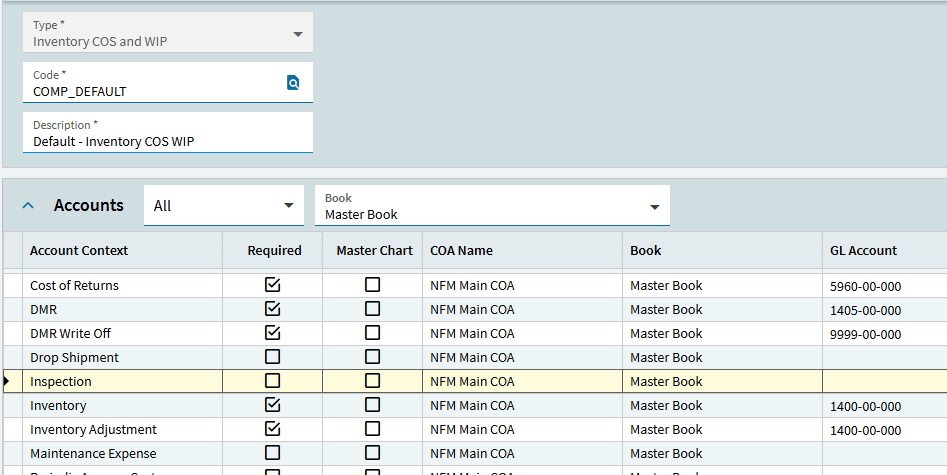

It doesn’t appear we have a GL Control for COS/WIP > Inspection.
So, I think the credits are occurring to our Received Not Invoiced account… but nothing is getting debited.
As a non-finance guy… does that smell right?
Agreed that that is your problem, yes.
So, to correct, we need to add a GL Account there, so the debit will land somewhere…
We need to delete the Review Journal…
Recapture the time period…
and things should then come into balance.
Yes?
