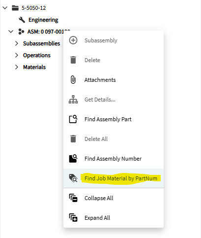

When you’re on the Assemblies page, the stock Find Assembly Part and our new Find Assembly Number tools are available in the overflow menu.
The problem is, if you’re on the Details or Activity tabs… our new tool is still visible:
