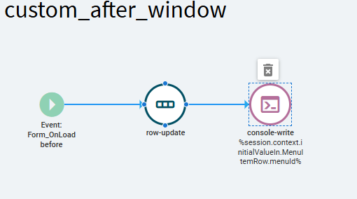

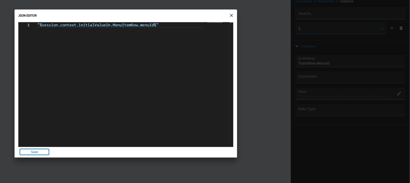

You can add a after or before formload event with a created a TransView column with
%session.context.initialValueIn.MenuItemRow.menuId% – Note this may be different for screens.
Then refresh the classic screen, open the Debug Tool and to go data and select TransView

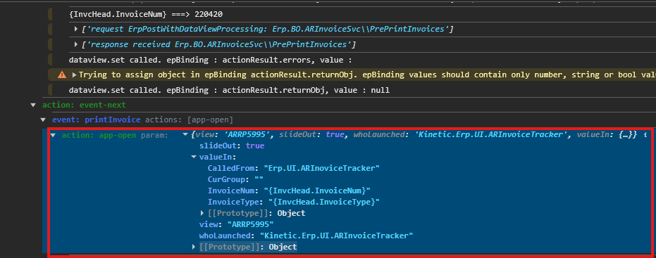

Other method, visit the page from a browser it will generally be in the URL if it’s not then open dev tools (F12) and enable debugging ( How To: Debugging Kinetic (Browser) - Experts’ Corner - Epicor User Help Forum)
and type (case sensitive) - epDebug.context, follow the tree down and find initialvaluein and follow it down you will see the menuid :slight_smile:
Ahh Ha! Thank you AAron. DevTools for the win. I was looking for how to find process menus like printing, etc. It stemmed from another post. I appreciate it.
