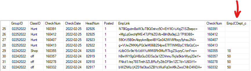

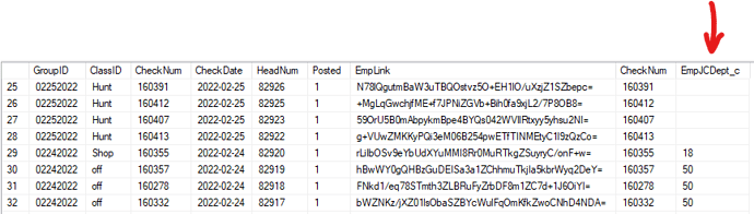

I’ve tried moving the value from erp.PREmpMas.JCDept into an existing UD column Erp.PRCheck_UD.UDColumn when checks are posted using a BPM. The BPM is attached to Erp.BO.PayrollCheckEntry.Update method with the following code:
   var PRCheck = (from row in ttPRCheck select row);
   if (PRCheck != null) {
     foreach (var r in PRCheck) {
       string department = (from row in Db.PREmpMas where row.EmpID == r.EmpID select row.JCDept).FirstOrDefault();
       r.SetUDField<System.String>("EmpJCDept_c", department);
     } // end foreach
   } //end if
The code works with some BPM triggers, but not all and I can’t figure out why. See evidence below:
