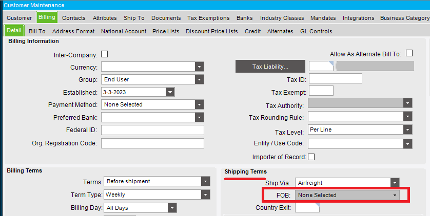

Hello EpiUsers,
Does anybody know the reason why the “FOB” field in the Customer Maintenance section of the Shipment Term group is disabled/grayed out?

Did somebody add field security on that field?
Do you have FOB Codes set up?
Is that screen customized?
Thank you for your feedback.
@aosemwengie1: There is no security in this field.
@klincecum: No, even when I open a form in base-only mode customization, there is no code for it.
The problem was fixed when I discovered that someone had set the FOB field’s Extended property to read-only.
