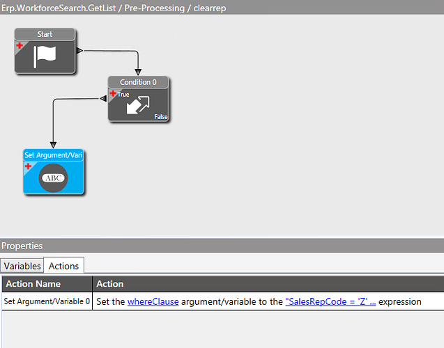

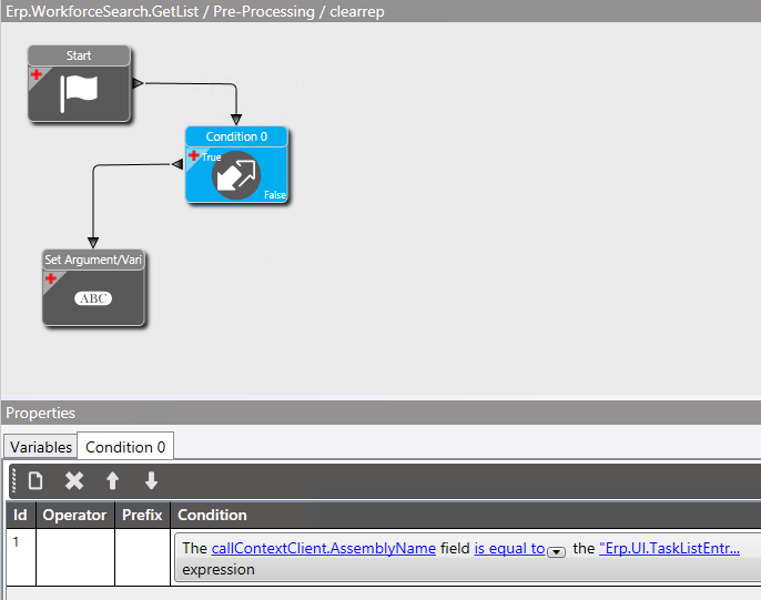

Use a BPM instead of messing with the customization:
Method: WorkforceSearch.GetList
(BE CAREFUL, this is probably used by other searches so you want to limit it with a CallContext condition like ProcessID, Assembly or CustomizationID)
When I attempted this, I first tried clearing out the whereClause Argument in a Pre-Process, but that didn’t work, not sure why. So instead I just redefined the where clause as:
"SalesRepCode = 'Z' BY Name"
And that seemed to do the trick. Feels like a hack though.
That is brilliant, it worked beautifully :slight_smile: Thank you so much!
It does what I wanted. The Debt manager is not all that computer literate and thought the task list was too complicated. So making a customization that will just bring up his stuff, in List view, so he can just mark the Complete button (after I add enough stuff to the grid that he can determine whether it’s good) will make his life a LOT easier.
