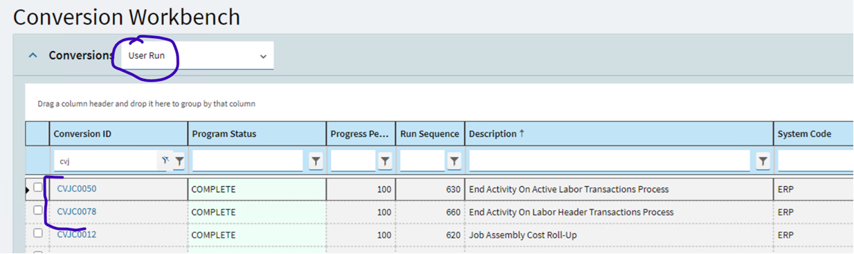

I found an older post mentioning the Conversion Workbench, but the ID mentioned in the post (CVJC0050) is not showing there.

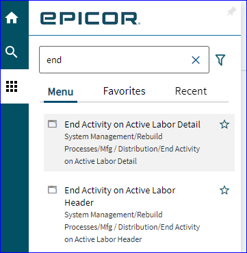

In newer version there are menu items for this:
In older versions there were User Run conversion you could try in Conversion Workbench:

Awesome - used the “End Activity” tools. Thank you!

They are now standard (as of 2024.1, I think) prior to that, you had to use Conversion Workbench.
