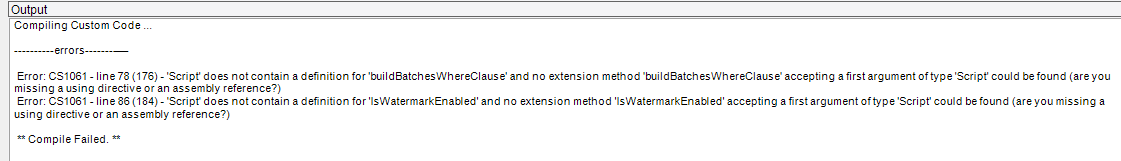

This is great thankyou but I cant get it to compile

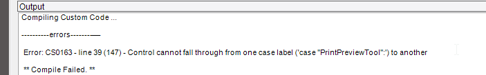

Thankyou - getting compile error:
EDIT
Here’s the whole function which seems to work
(looks like I left out a break; or two when I was tidying it up)

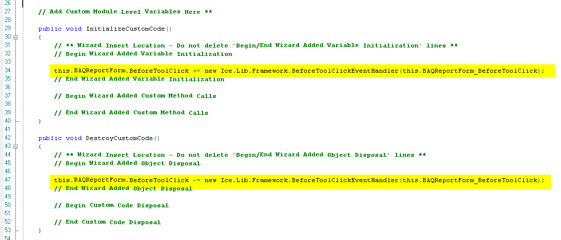

Did you use the Form Event Wizard to create the function, or did you just copy and paste it into the Script editor?
The later (just pasting the function) doesn’t create the necessary calls in
public void InitializeCustomCode() and public void DestroyCustomCode()
Either manually add those two highlighted lines, or use the Form Event Wiz to add them and the empty function for BAQReportForm_BeforeToolClick

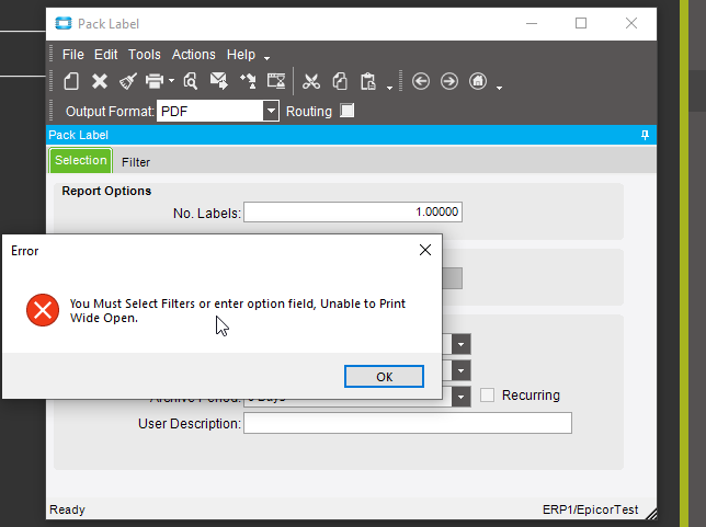

I was only testing it with PrintPreview, and had closed SysMonitor :man_facepalming:
The warning did show, but still printed

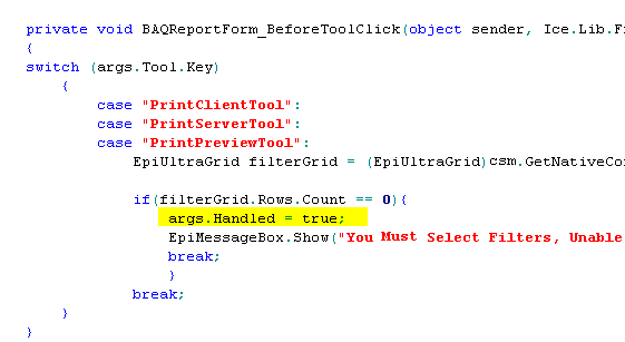

The sample code doesn’t include anything to stop it from printing. I’ll look for that.
Add args.Handled = true; as shown below. This will trick the button click into thinking it was handled, thus not causing it to submit the task. After clearing the message box, the status bar still says Ready (like you never clicked a button)
