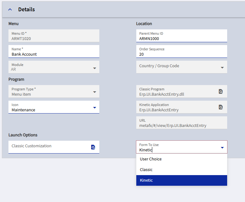

I have no problem setting the form to use. Yours is disabled?

I don’t know what you guys are saying, lol. The “Form to Use” field is editable for me and always has been. And no, I don’t have any cusomization in place. This is straight from demo.

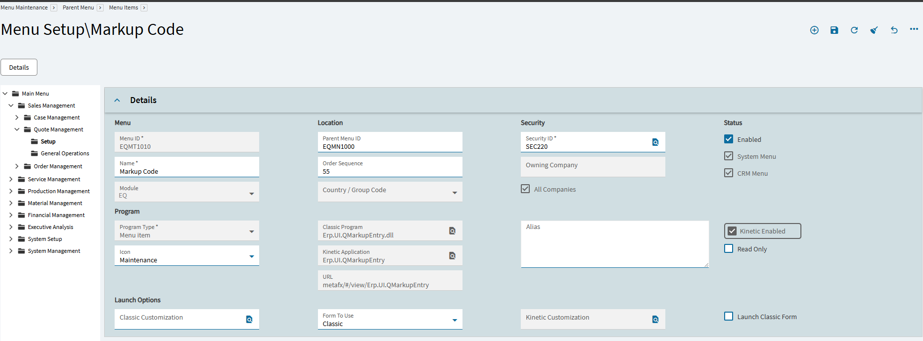

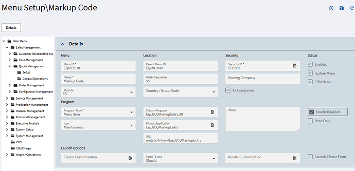

Not for me:

I haven’t changed anything else except Form to Use, but it look like I can.

You guys on prem? Wonder if it’s a SaaS thing…
Maybe the difference is prior setup? In new cloud environments, I see that the copy to current company feature is required to edit menus, but not on an upgraded database.
edit: also, maybe SaaS vs On-Prem.
On-Prem here and I have the same edit ability as @mbayley without having to copy the menu.

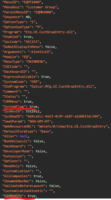

It looks like the GetRowMenuMaint endpoint returns CanModify = true for all menu items.

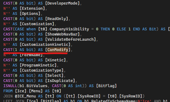

I dug into the stored procedure source for GetRows, and it looks like they’ve hardcoded it always to be true (for us at least).
