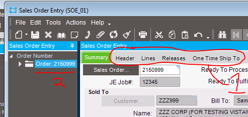

I customized the Sales Order Entry form, and now the tabs (#1 in pict below)) don’t respond unless I first select the Order Number in the tree (#2 in pict)
When the form first loads (i.e. no Order selected, I cannot select the other tabs. I can do this with the base form.
And when I open the form in developer mode, I can’t select the Header, Lines, or One Time Ship To tabs, to customize their content.

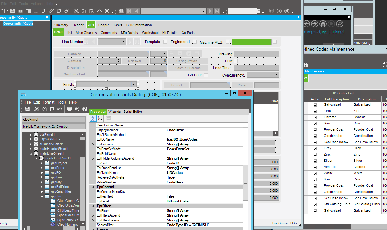

We use User Codes to create lists for epiCombo drop downs like this:

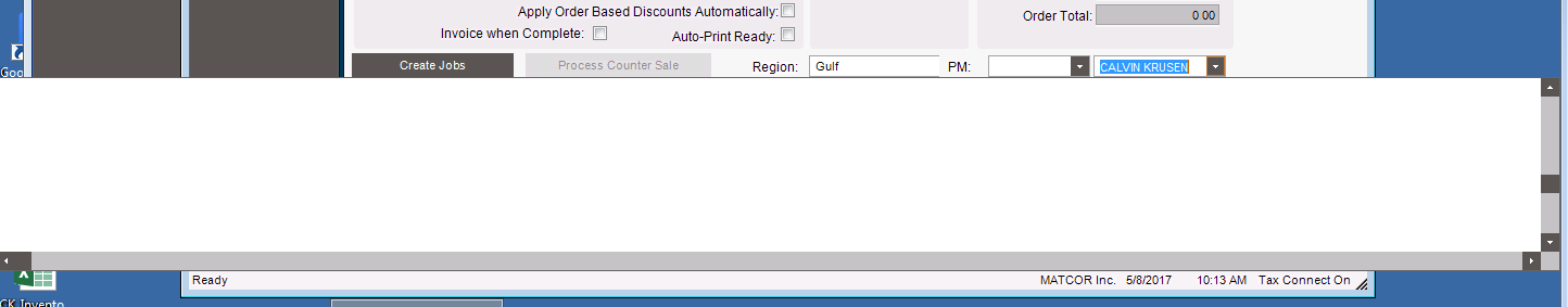

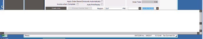

I tried using an epiRetrieverComb control ( selecting my UD table). But the dropdown list does not autopopulate from the UD table entries.
It shows a large blank list with scrollbars.
I scrolled around the dropdown, but there’s no text in it.

I only selected “UD05” from the retrieve selection. I forgot to expand it, and select “UD05 Combo”
Well that wasn’t it. I get the same results (the retrieverCombo dropdown is still blank).

I actually got it working by using a regular epiCombo (not an epUltraCombo), and set the EpiBOName to Ice:BO:UD05.
Also had to set the DisplayMember, EpiColums, EpiSort, and ValueMember fields to ShortChar01 (thats the UD filed that shows on the form and needs to bestored in the OrderHed.PM_c UD field.
