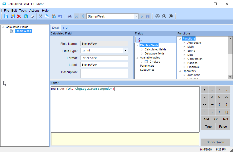

Works fine here.
Are you using “Week” as your field name? That won’t work. Choosing an Integer for the return? Can you elaborate what “can’t seem to get DATEPART to work” means?
