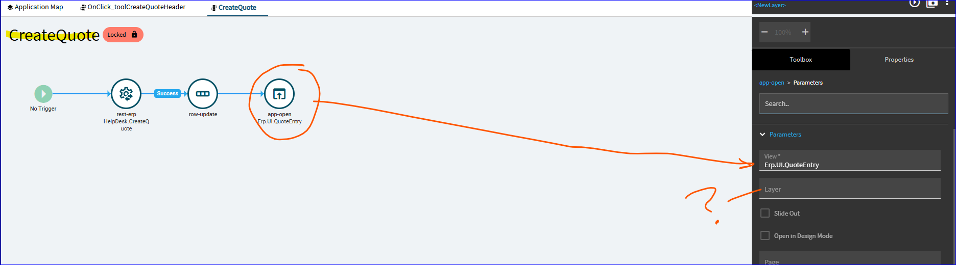

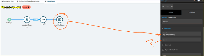

Summary: Example of the pain point… I apply a custom layer to Quote Entry (most of us probably have). However, any form in the system (Case Entry was the latest one I helped with) that has an app-open event to access Quote Entry defaults to only loading the base Quote Entry form. Therefore Case Entry (and any other form in the system that has an app-open event to access Quote Entry) must then also be customized.
Customizing one form ends up requiring the creation and maintenance of customizations on several others forms just to access it.

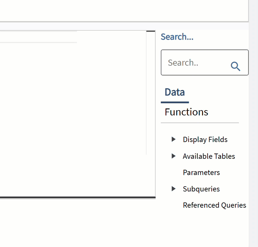

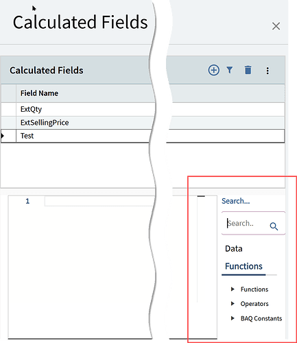

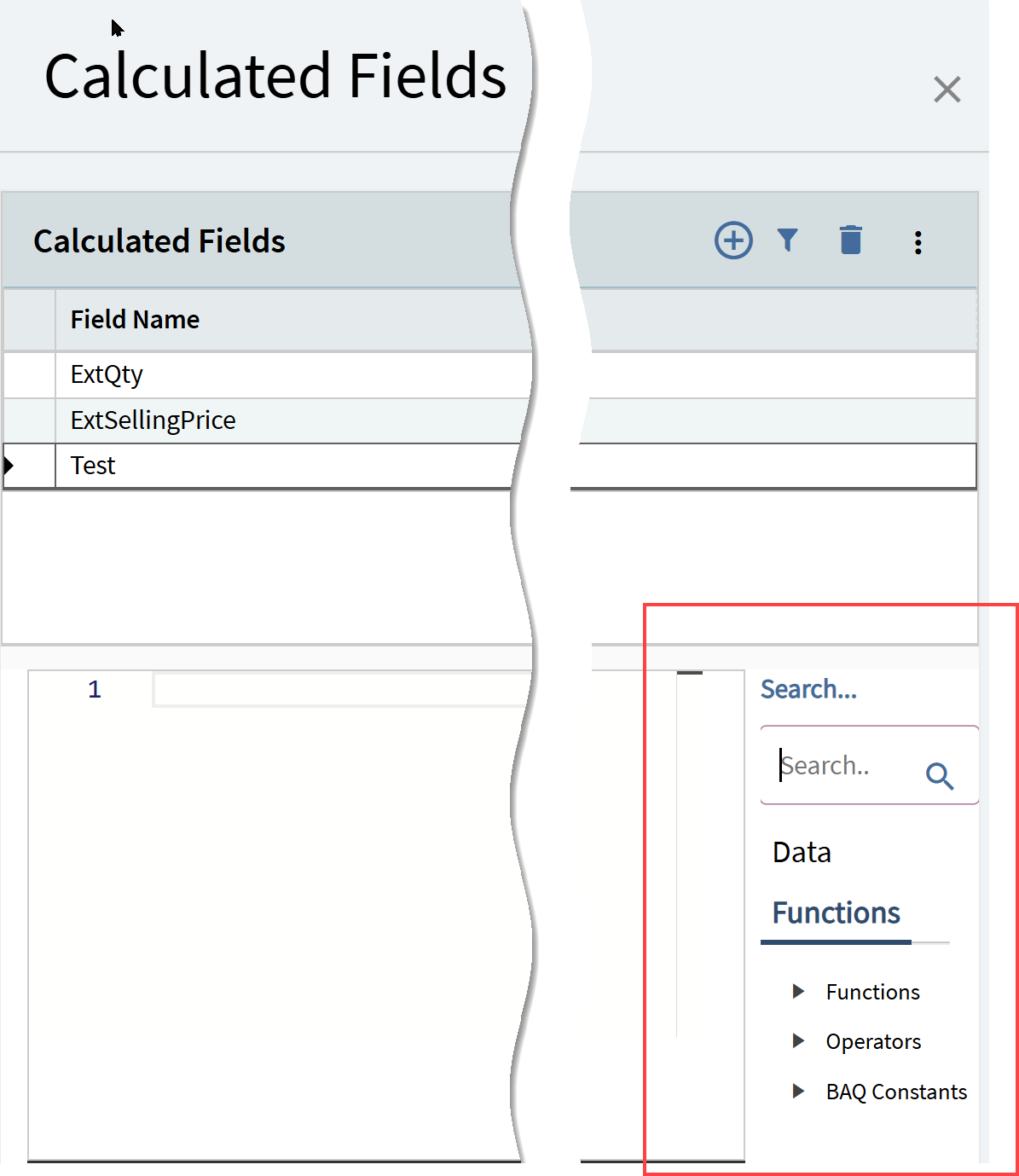

In the new BAQ process I have found building a formula easier now because I can search for both fields and functions just by keying in the a portion of the field name.

Here’s the post that basically stemmed the idea, but this is probably the 5th or 6th person that I’ve personally helped with… and I’ve seen others helping with this same issue as well:
The main issue (in this example) is opening Quote Entry from Case Entry is being driven by Application Studio events. So, even if you have a custom layer on Quote Entry in Menu Maintenance, the App Studio event calls the base form only.
I won’t re-write the whole situation here, but it is in the above linked post if you want more details.
