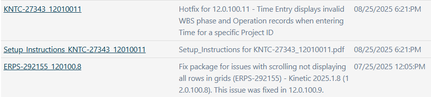

At least for the on-prem folks, these are the only two hot fixes available for K2025.1 to download:
