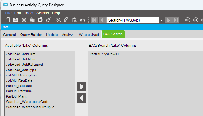

I know adding the PartDtl.SysRowID field to the BAQ Search is typically how we add queries to fulfillment workbench, but I keep having issues where the queries still wont show even with this.
Is there any other conditions that have to be met in order for a query to show in fulfillment workbench?

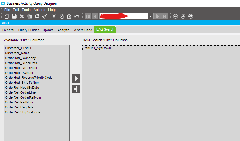

Here’s what ours looks like, works a treat:
Possibly due to the table having an alias?
Many thanks,
Nathan
Pretty sure you got it.
His says PartDtl1.SysRowID

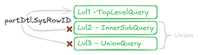

I ended up removing the two instances of PartDtl in the sub-queries, and replace them with one instance connected on the Top Level.
FWIW, the only reason I had two instances of PartDtl was because I’m doing a Union between two sub-queries, and I thought I saw a performance improvement when linking PartDtl to OrderDtl, as opposed to PartDtl linked to a sub-query.

If you ever can’t get away from multiple table instances, you can remove all copies of the required table then add it back to top-level query first to ensure it has the table reference without an alias. It’s a bit of a pain but it works.
