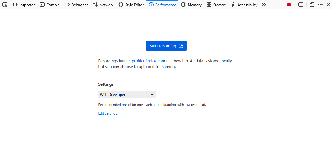

I’m not on that version but could you use the Performance tracking tab in Developer Tools in your browser to see if it will say exactly what is causing the slowdown? Hopefully it doesn’t just say the name of the Function but worth a shot.
