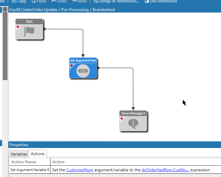

Works fine for me. You’re doing something else wrong. You’re going to have to show us what you’re doing for anyone to actually help you.
I think I resolved it. I rewrote my directive to a Post Processing directive. I was trying to use a Pre Processing one.

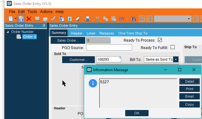

You must have changed something else then. What I just showed was a pre-processing and it works fine.
