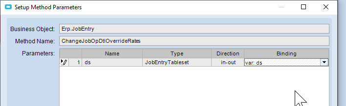

After doing a trace i can see that I need to set the OverRideRates field to true and then call the ChangeJobOpDtlOverrideRates method which takes the dataSet as an input. I did the same in the BPM but it is failing because the JobOpDtl table is missing from the dataset. Note: I set the ds variable in the method call to ds as well.
Here the method call setup:

you need to determine what parameters JobOpDtl needs to be updated, by default the first one is the RowMod==U, Company, JobNum, OperNum, OpCode, etc, then use Fill table widget to read from ttJobOper table (ds) to fill into JobOpDtl, to invoke the update method, this is how widget should be used, alternatively you can do the same by Custom Code
