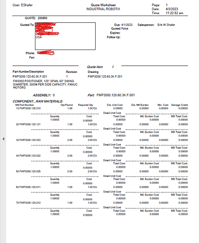

The BOM cost report actually captures everything where the quote worksheet does not. Why?

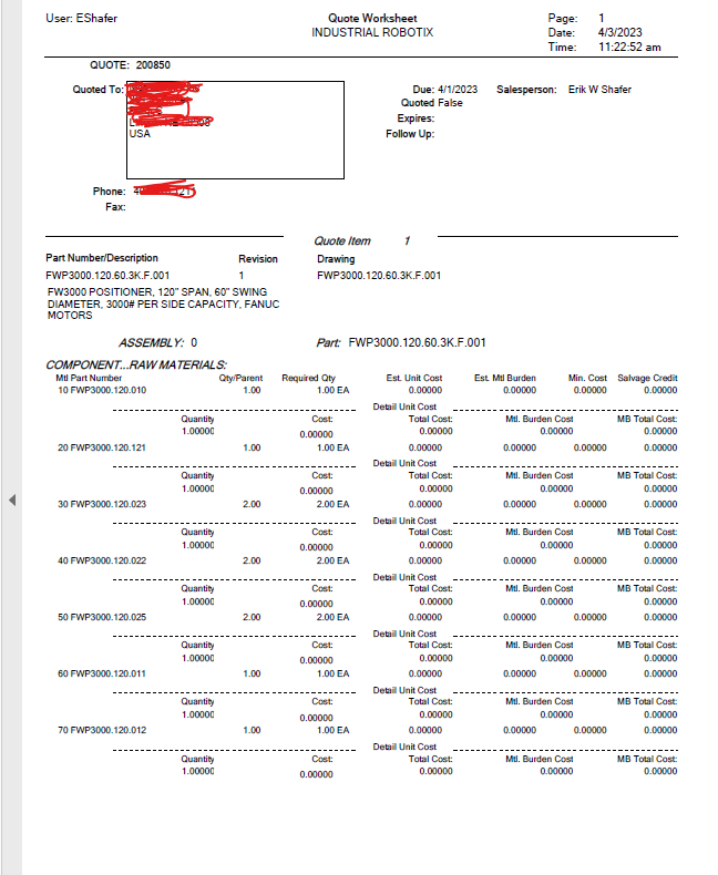

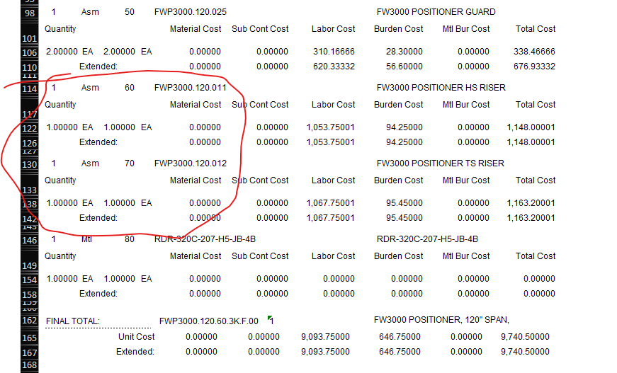

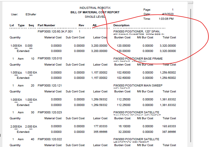

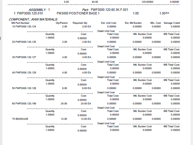

Here’s a BOM Cost Report, the items FWP3000.120.011 and .012 each have assembly items on them that utilize P.1.48.96.A36 in their methods. They’re sub-assembly weldments all in the FWP3000.120.60.3K.F.001 assembly. When I built the method it did not allow for “sub assemblies” just operations and materials.
First pic below of the BOM cost report in excel, circled are the areas where material cost should be tallied.

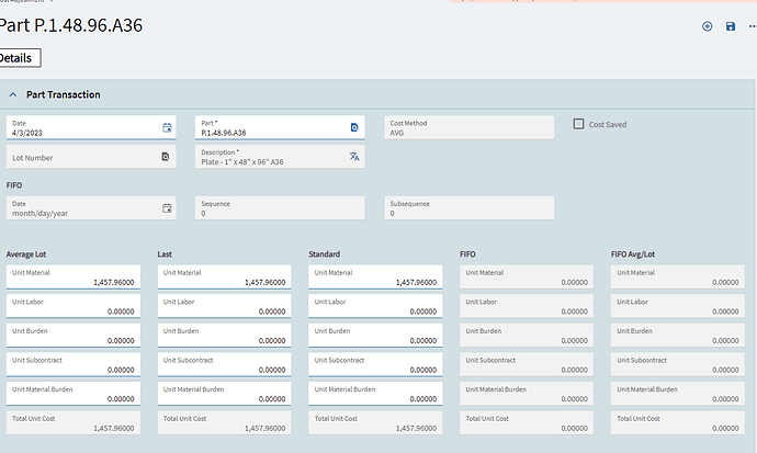

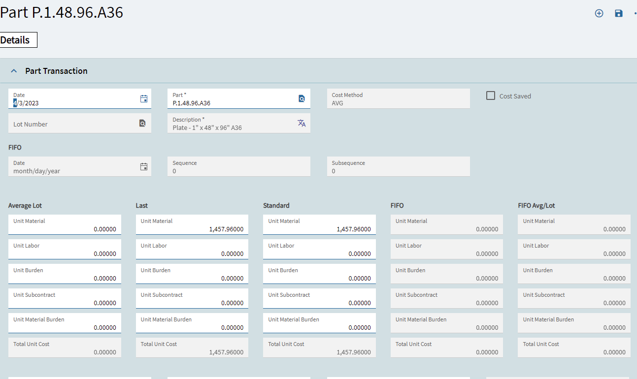

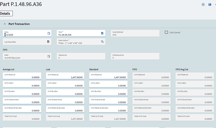

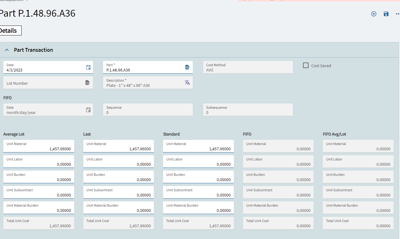

Below that is the Cost Adjustment screen for P.1.48.96.A36

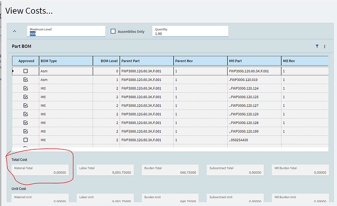

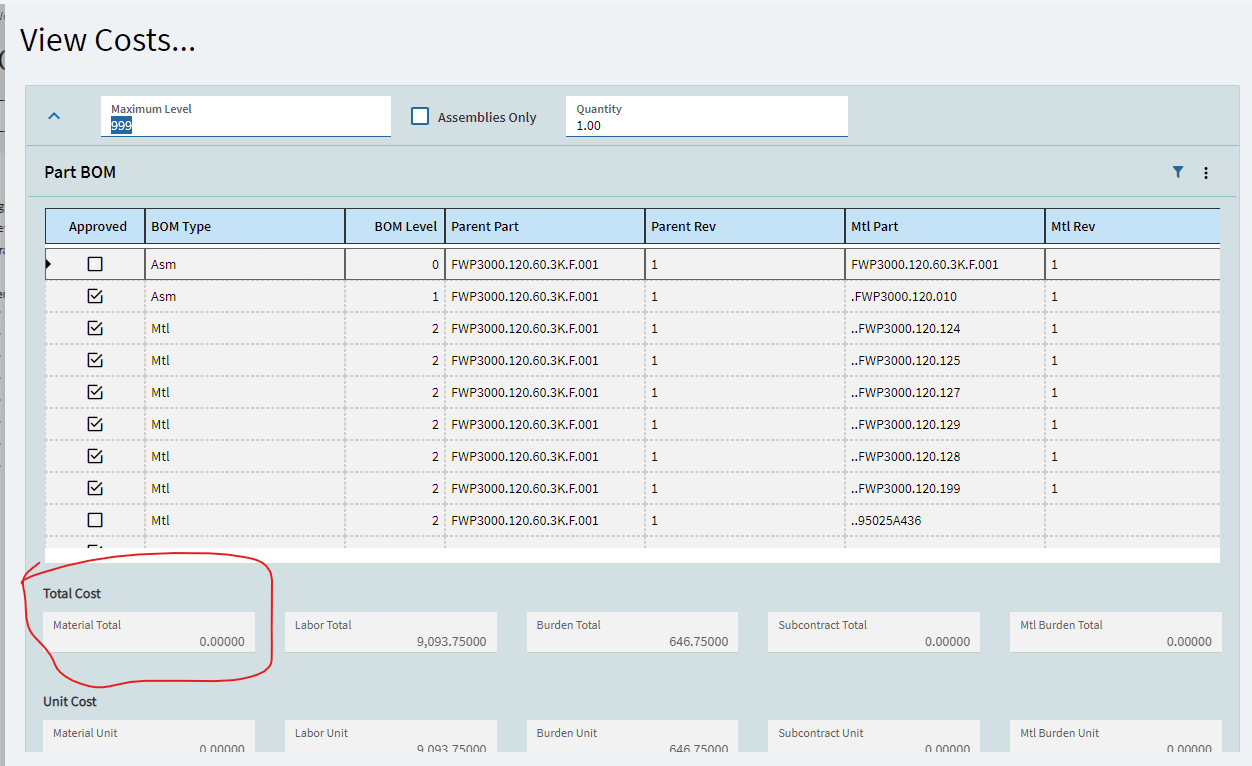

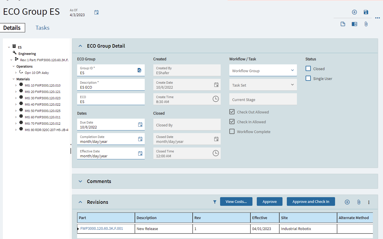

Below that is “View costs” in Engineering Workbench for FWP3000.120.60.3K.F.001 and material cost is zero.

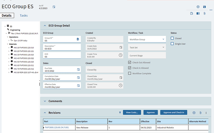

Bottom pic is the method for FWP3000.120.60.3K.F.001

Yes, I tried that. Quote aside, it’s not updating material boxes in the BOM Cost Report itself, or when selecting “view costs” in the Engineering Workbench.

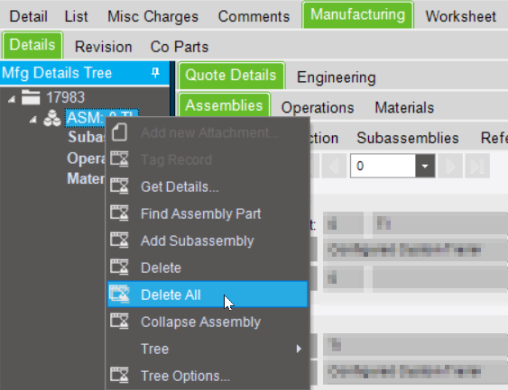

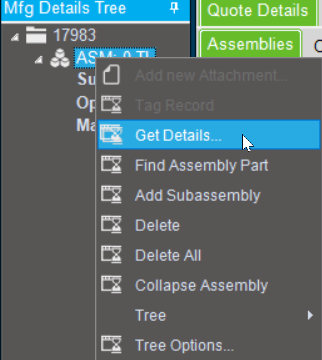

@anon99908839 Best is to delete all and the re-add get details. That is usually the only way the quote worksheet will update for our configuration

I did a Cost Adjustment to all the raw material parts. I am still getting zero dollars for cost on the assembly items associated.

Is this a configured item and/or something with manufacturing details? Have you done a cost roll? The Quote will not load updated information unless you refresh the line items… Delete All in the tree view then Get Details again or readd them…
