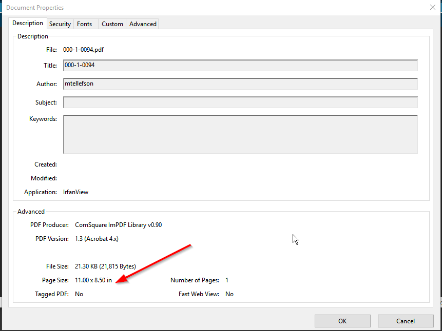

Can I get to this property in a file? My googling is showing mostly stuff about setting printing properties, but I just want to read a file property. Unfortunately, I think this one is actually buried in the file so I don’t know if I can get it without opening the file.
