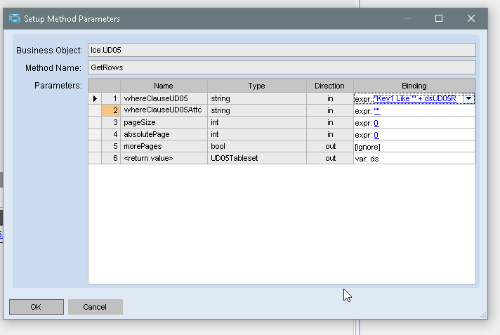

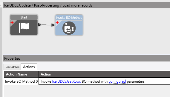

You could use a post proc on BPM on UD102.Update(), that calls UD102.GetRows().
All you have to do is set the WhereClause parameters in the BO widget.
This will fire whenever a record is saved. One down side, it will leave the previous records in the form, but you could probably clear them with a minor UI customization.
