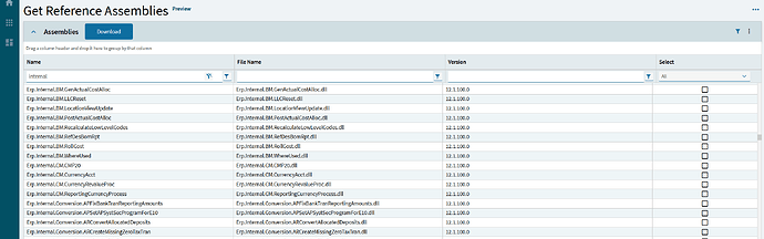

I redid this dashboard to clean it up and add the ability to download multiple assemblies in one zip file.
For this dashboard to work, requires one layer, one function library, and one bpm.

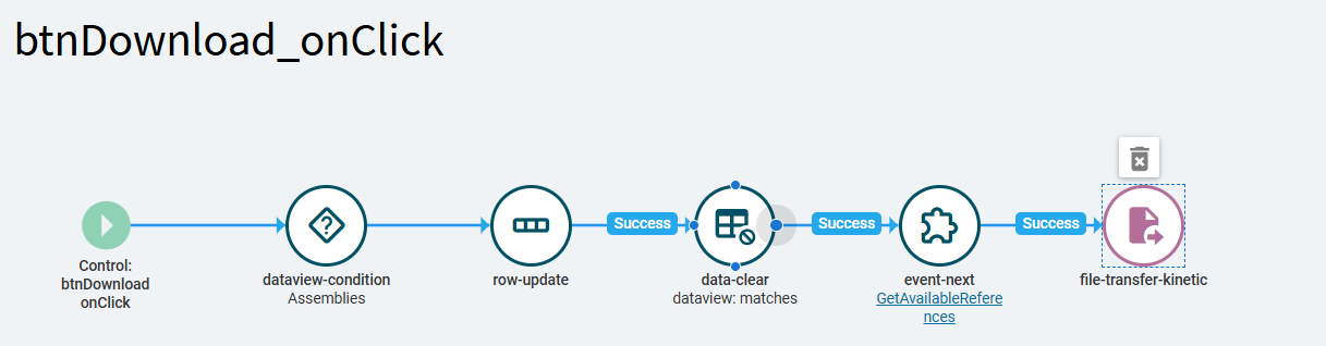

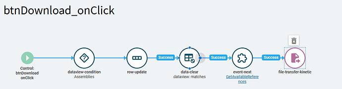

Pics:
The relevant magic in the app..
