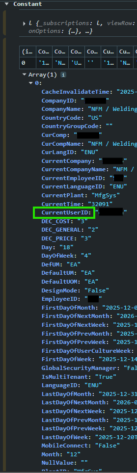

Constant.CurrentUserID is a stock dataview column that is always available.
If you look in debugger at the Constant dataview… you’ll see all the fields that are available for stuff like this:
