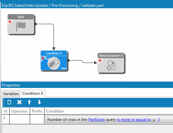

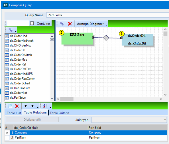

@jplafleur You can do this in Update without any coding.
SalesOrder.Update
Query
