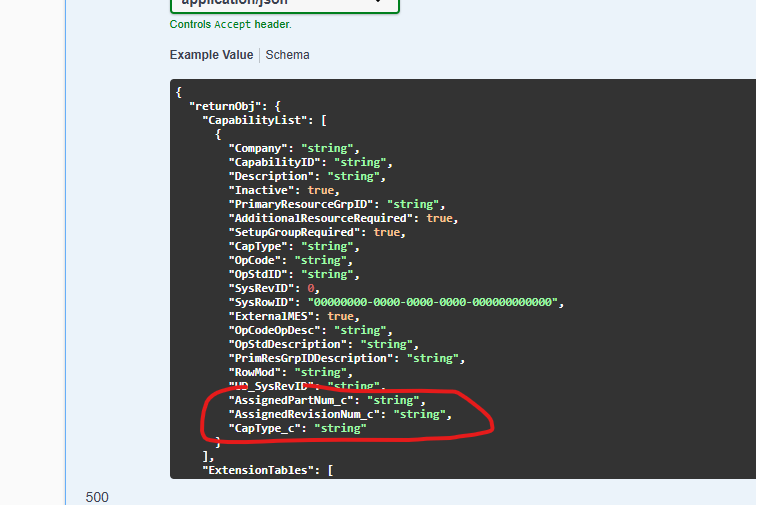

Currently facing an annoying issue with version 2025.2.5.
According the API service UD fields should be returned using a GetList functionality.
In my example GetList from Erp.BO.Capability.

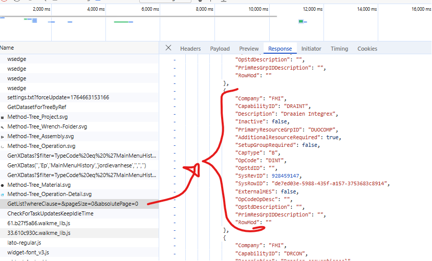

Below a simple rest-erp / rest-kinetic widget calling GetList from Erp.BO.Capability.
Anyone know how I can get the UD fields as well or might this be a bug?

GetList has never returned UD fields (on purpose)
It has always been a call to GetRows to get them. There were a couple of versions where this worked but I think it was mostly happenstance
GetList is meant to return the very basic list of principal fields that are returned on a basic search. It has always been limited in scope

The documentation is auto generated based on the dataset and the dataset does contain those fields but they’ll be blank
