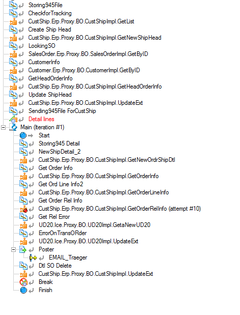

I’m troubleshooting a service connect workflow that a previous developer created. It basically takes in an order xml file to start and runs through various processes to mark the order as shipped and closed. Here is an overview of the work flow:
I have no idea why it would be unable to obtain the order release info.

These errors appear at random it seems like. There is no rhyme or reason. The 945 xml order file comes in complete. Here is the full error along with the datasets (you may want to copy into notepad++ and use xml pretty print to format it):

So it happens at random but not always? almost sounds like a connectivity issue to me…
I agree, if its intermittent, I’d look into connectivity. You can set retries when trying to access BO’s or at a minimum put an error check path in to detect when a timeout occurs.
Thanks guys. We are hosted by EMS on their servers fully so I could have them check that. Also this is set to retry 10 times in 3 sec intervals. Hmmmmmm
