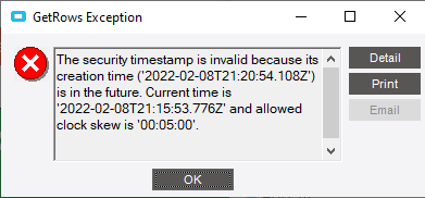

GetRows Exception - Security Timestamp
We use an on prem set up and using a client/server set up via remote desktop connection. All of our servers were restarted. We cleared up this problem for about 90 minutes but EVERY user is getting this issue. All of our clocks are correct, correct time zones. At a loss. Anyone else have this issue? I would appreciate any and all help to get rid of this nuisance window.
Here is the error detail:
Application Error
Exception caught in: mscorlib
Error Detail
Message: The security timestamp is invalid because its creation time (‘2022-02-08T21:20:54.108Z’) is in the future. Current time is ‘2022-02-08T21:15:53.776Z’ and allowed clock skew is ‘00:05:00’.
