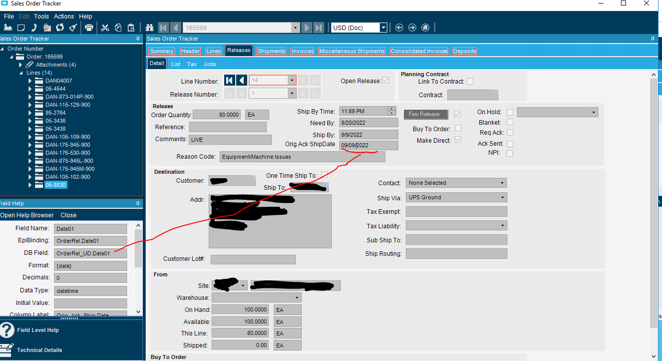

I’m trying to get this UD field from OrderRel here and assigning callContextBpmData.Date01 to it, but it keeps showing up blank. Am I missing something?

You should not have to try that hard. The UD fields appear as standard fields in most cases… you should be able to simply call it out as OrderRelRow.Date01
I tried that, it still returned a blank unfortunately despite a value existing for the SO release I am shipping.
