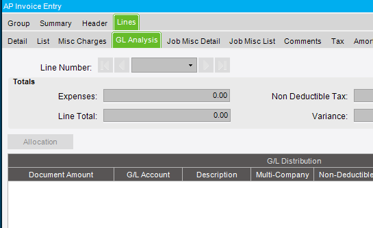

Hi Nate, I don’t THINK you can change the receipt GL at Receipt Entry. However, I believe it can be changed on the GL Analysis tab of AP Invoice Entry. Have you checked this in AP Invoice Tracker to verify if the change was made there?

When you create the AP invoice and retrieved the lines etc they information should show on the GL Analysis.
