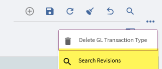

You may not have noticed a “new” feature.
Someone in development thought it was a good idea to automatically hide blocked revisions from the tree.
To unhide them you have to search specifically for them to be shown.
Considering that the GL Transaction (Posting rules) is a maintenance process that is rarely used, hiding things is not a great idea.
But when you are developing a revision, you may want to go back to the blocked version to use it as your base.
After creating a new active revision, blocked revisions are not shown in the tree view anymore.
You need to manually search for the revisions for them to show in the tree view.
  1. In GL Transaction Type screen, select the transaction type you created the new revision for.
  2. Overflow menu - Search Revisions

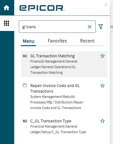

Can you tell me where to find the GL Transaction Type form? I have a menu item that ties to the Classic version of the GL Transaction Type form, which I have to go to after every software update, since at least one of my processed always ends up inactive.
I have not been able to find the Kinetic version of the form for a while, and I’m concerned that eventually my classic form will no longer work.
The program is called GL Transaction Type, and its under Financial Management / General Ledger / Setup
That’s where I thought it would be, but I’m not seeing it.
If I search for GL Trans, this is all that is returned:
The C-GL Transaction Type is the menu item we created to access the Classic version of the form.
Is there any way it could be hidden? We are on version 2024.2.12.
Have you tried the C_GL Transaction Type menu item showing in your screen shot?
I have…that is a user-created menu item that opens the Classic version of the form.
I’m looking for the Kinetic version
If the Classic version has been customized then it can only open in Classic. If the Kinetic version has been removed from the menu then it will need to be re-added, or if it’s security access has been changed then someone will need to update that. But be aware the Kinetic version will NOT be the customized screen you’re used to, it will be the default Kinetic screen.
