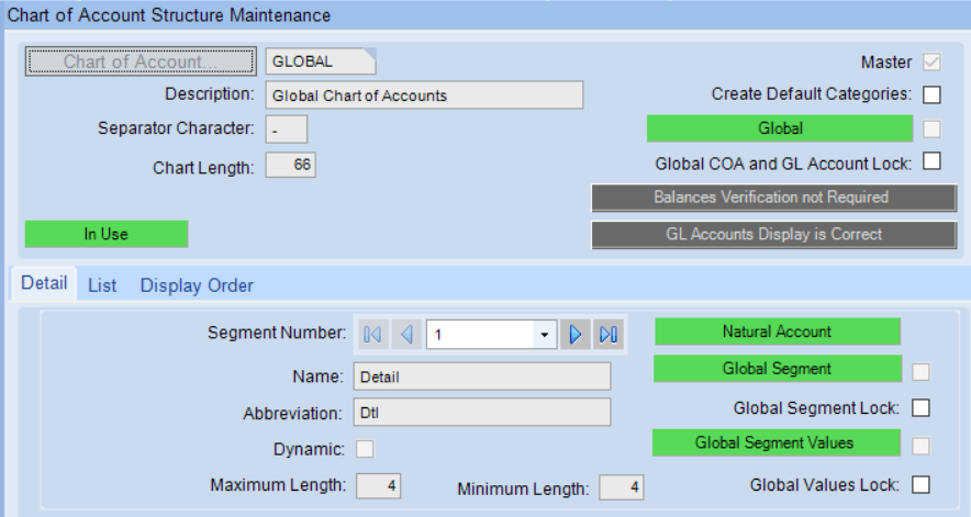

When we try to update the description for some values DMT errors out saying we can’t update values flagged as Global, so we tried to flag the CoA as not global across all companies through DMT, but even the DMT is running perfect without any errors Epicor is not updating the CoA and still flagged as Global and the checkboxes are greyed out.
I’m pretty stuck and have no idea what to do next. Any ideas?

Tried that already but even the checkbox is not selected, the GLOBAL “Label” is still active (green color highlighted).

Try ticking Global COA and GL Account Lock - this will delink with Global COA
Is greyed out so I can’t tick it

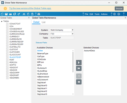

Have you looked at the “Global Table” app? It could be forcing that to be read only from the parent there. We use this to control which fields the non-parent company can alter on the data. Maybe the description is being forced from the parent, in which case you could move it from “Selected Choices” to “Available Choices”:
e830307095b59e57264c7d4cbbe7508b9a7b6b3c_2_448x375
all of that is set up correctly, I reviewed it few times and all good
